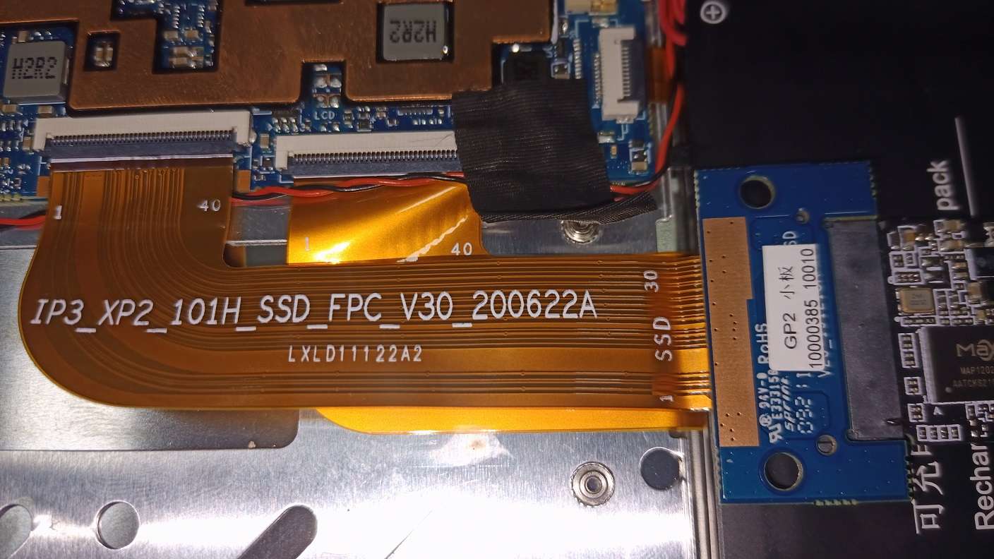

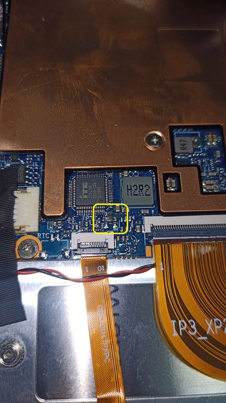

I tried to install an NVME SSD in my Iwork 20 unit, but, the SSD connector connected to the mother board via the IP3_XP2_101H_SSD_FPC_V30_200622A ribbon cable is, probably installed inverted and my SSD disk need to be installed inverted too, when I tried to turn on the unit, a transistor located at left of the pin number 1 (of the SSD Ribbon connector on board)just heat and be deformed, I´m not sure about the rigth part number of this transistor I can see clearly a “M0_” I´m not sure about the last number, I remove battery connector and remove the SSD drive and turn again Iwork 20, it run normally but I´m just wondering what could be wrong in my device, why I can´t to install an nvme disk drive and get more spcace and speed …

I think, my issue is I tried to install an M.2 NVME and unit support M.2 SATA, let me check and update my post…
Regards…
