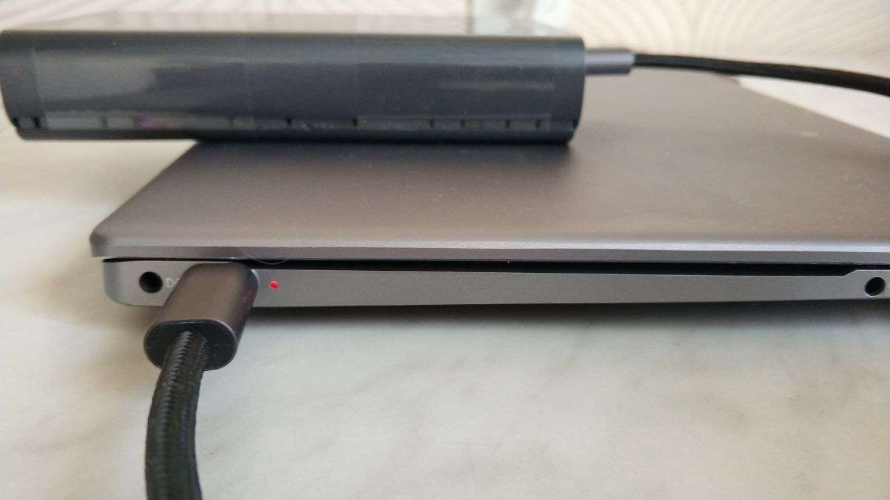

My Alldocube GT Book will not turn on after leaving the charger connected to it for the last couple of days.  When connected to the charger it shows a red led light right next to the charger connection, If the charger is disconnected from the laptop, no led light is visible at all.  Problem is that I purchased this laptop on August 8, 2021 and it would not start on again. Almost exactly one year and a day since it was ordered from Amazon. Is the warranty over on this thing?  All I need is to get it fixed please.

No it will not turn on at all nor will the led indicating that the charger is connected to the laptop is lighting up.  What is strange is after attempting to make it turn on , Windows 10 loaded once and then all of a sudden it turned off completely and that was the end of any attempts to make turn on. I think the battery must have had some charge left in it, but since it is zero now it will not turn on at all.  Not sure if it is a battery issue or the charger since the led light that would indicate it is charging is not lighting up.  Tried to plug the wall outlet plug on/off to see if it will somehow start nothing happened.
