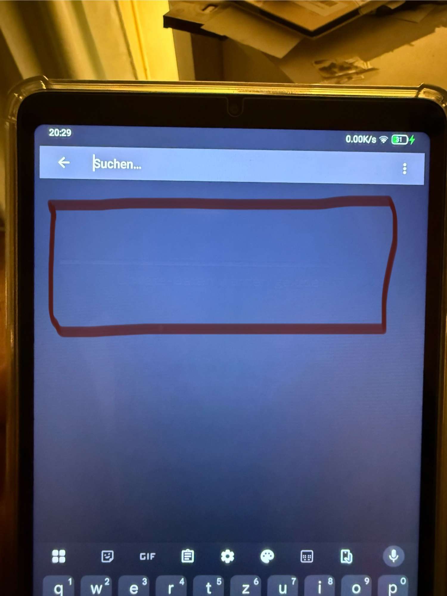

i noticed also that if a static picture is shown like the systemupdate screen it will make some kind of burn in. ( you can see the text is burned in in the settings search field) this was before the reset and is still the same after the reset but not so noticable then before. another example is if i watch netflx and its not fullscreen (16:9), then you have black bars on top and bottom of the screen. after 20 minutes or so the black bars are visible in the grey search field. it goes away with the time but i want to know is this hardware issue?  or fixable via ota update. also i want to know if the screen twitching is a hardware or fixable software issue.

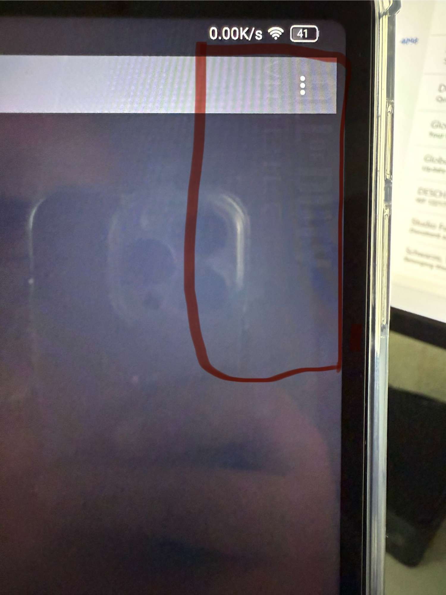

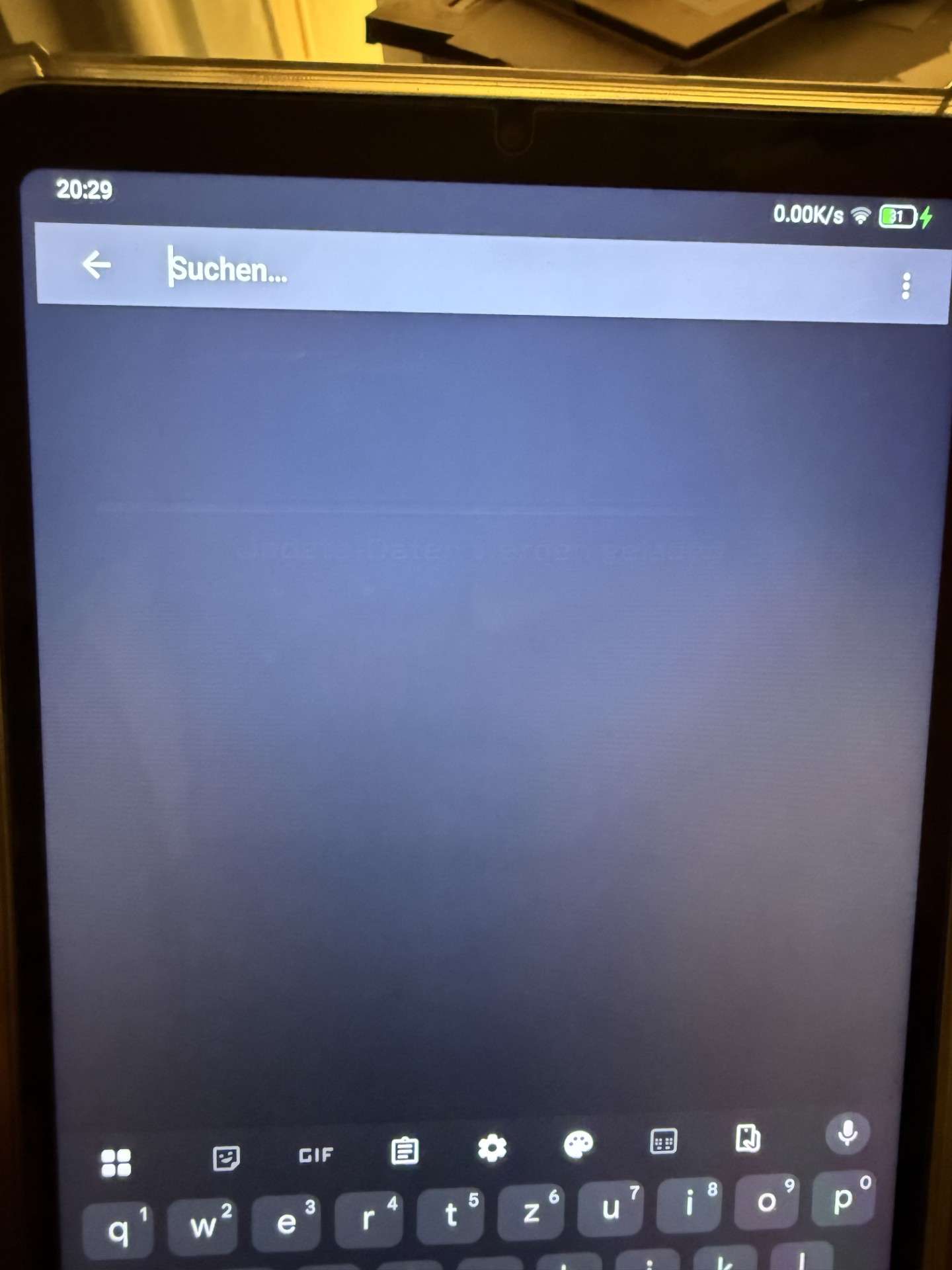

thumbnail_IMG_2501thumbnail_IMG_2502thumbnail_IMG_2503I had so far 4 Units and all of them had the Same issues but the worst thing Nobody noticed is the Display burn in. It leaves Ghostimages after 10-15 Minutes of use. I will make a new seperate topic for this. Oh and all 4 devices had this Problem.
For example just watch something In netflix 16:9 you have on top and bottom black Bars. After only 1 Episode lets say 25 minutes. The Black Bars are Kind of burn in the Picture.
its not visible directly, but if Open up the search Menue in settings (the grey one) It is visible.
the Marks Go away with time but this is very Annoying. Please Test it for yourself. Im sure every Single Unit do this. Best way to See it is the Search menue in settings or the System Update Screen. Open one of them up after you watch something With Static pictures or black Bars for 20+ minutes
i First Realise this After the systemupdate. It Took maybe 20 minutes and after that I still had the Text from the Update Picture visible in the grey search Field.
Please Test it out and Report it here. This is inacceptable
