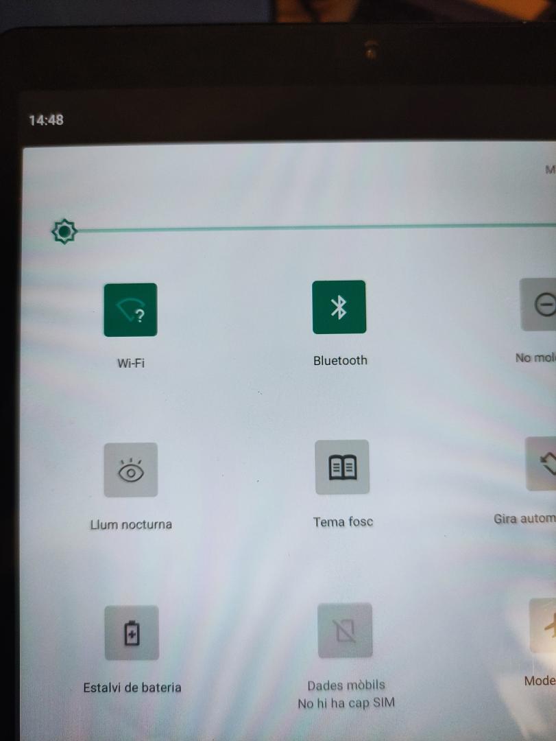

I recently bought an Alldocube iplay 30 pro and wifi disconnects randomly and the signal appears with a question mark after this disconnection, I am at 1 meter of my router and it cannot reconnect automatically, I have to turn the wifi of the tablet off and then turn it on again.
Webp.net-resizeimage
I have flashed the last firmware that I found in this web but the problem persist.
It’s almost impossible to watch a video on YouTube at once… any solution for this?

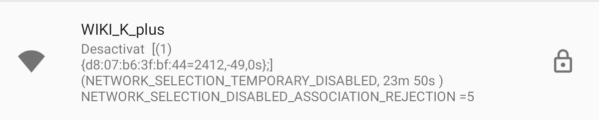

I have more info about this issue, network state appears with messages:
NETWORK SELECTION TEMPORARILY DISABLED
NETWORK SELECTION DISABLED ASSOCIATION REJECTION
Screenshot_20210213-111752~3

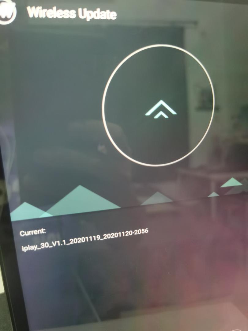

I tried this method but do not work for me. And I also tried to use both methods Randomized MAC and Device Mac both also don’t work. Does anyone have the same experience?
Below is my firmware version.
IMG_20210302_145710_resized_20210302_034900527
