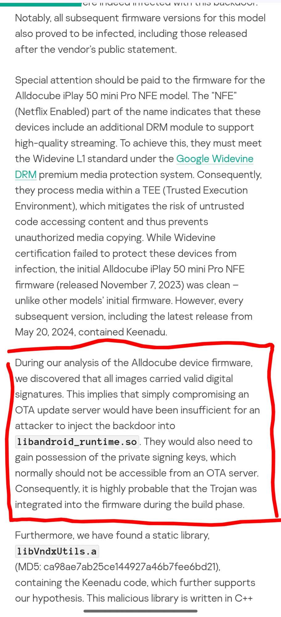

I am writing to report a serious security concern. Kaspersky has recently detected the Keenadu Trojan (an Android backdoor) pre-installed in the firmware of many iPlay 50 Mini Pro tablets.
Please read the full technical analysis here for more details: https://securelist.com/keenadu-android-backdoor/118913/

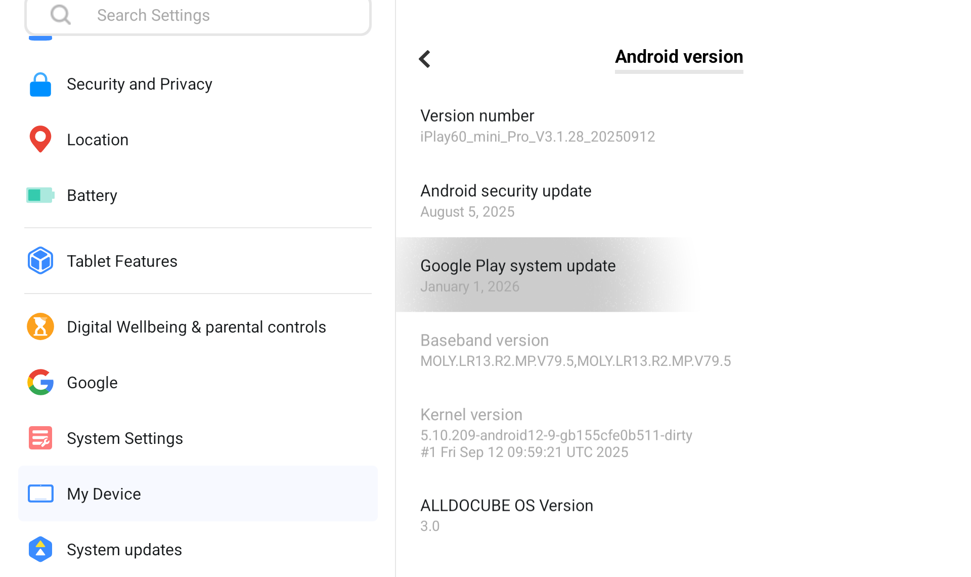

I’m a iPlay 60 Mini  Pro user, and I also found the same Trojan scanning by Kaspersky Mobile Antivirus. Kaspersky’s report suggests this is present on all models. I’m not sure if it’s a Trojan created by Alldocube. Please provide a response to users as soon as possible.17714690892331771469092040

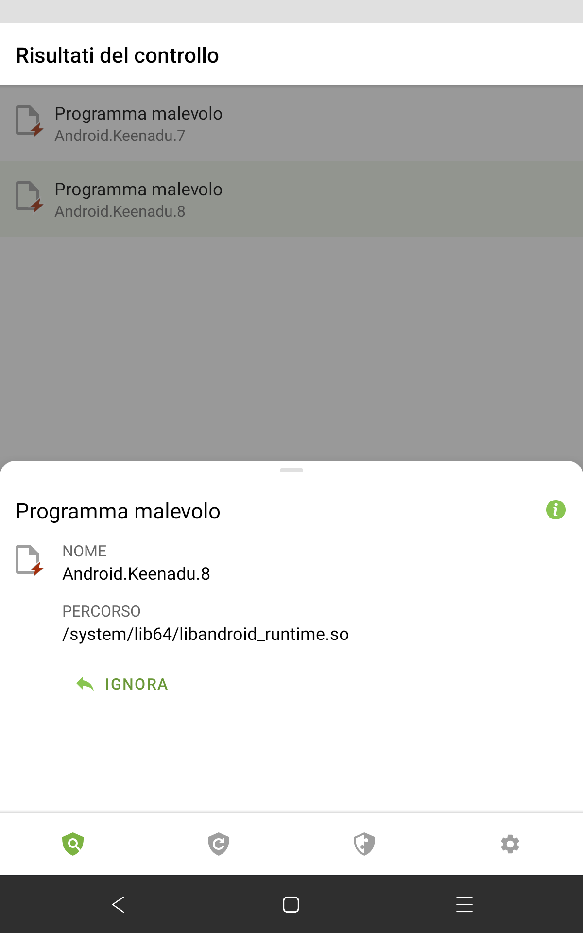

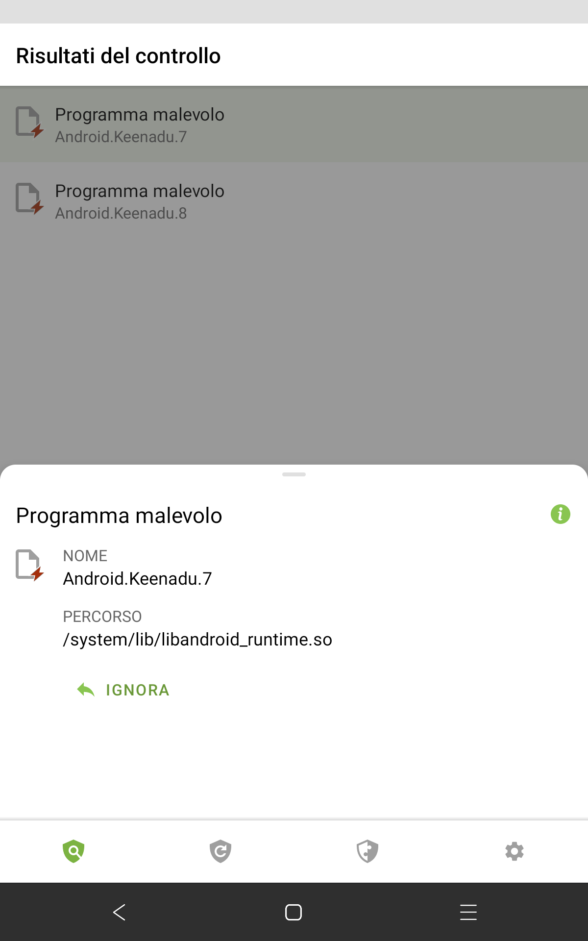

Hello again everyone, I have an update on this.
You can check if your device is affected by performing a full scan with Dr.Web, which is available on the Play Store.
I am attaching a screenshot of my iPlay 50 Mini Pro showing the detection. I also ran a full scan on the 10-inch iPlay 50 Pro model and that one resulted clean.Screenshot_20260219-105935Screenshot_20260219-105945
