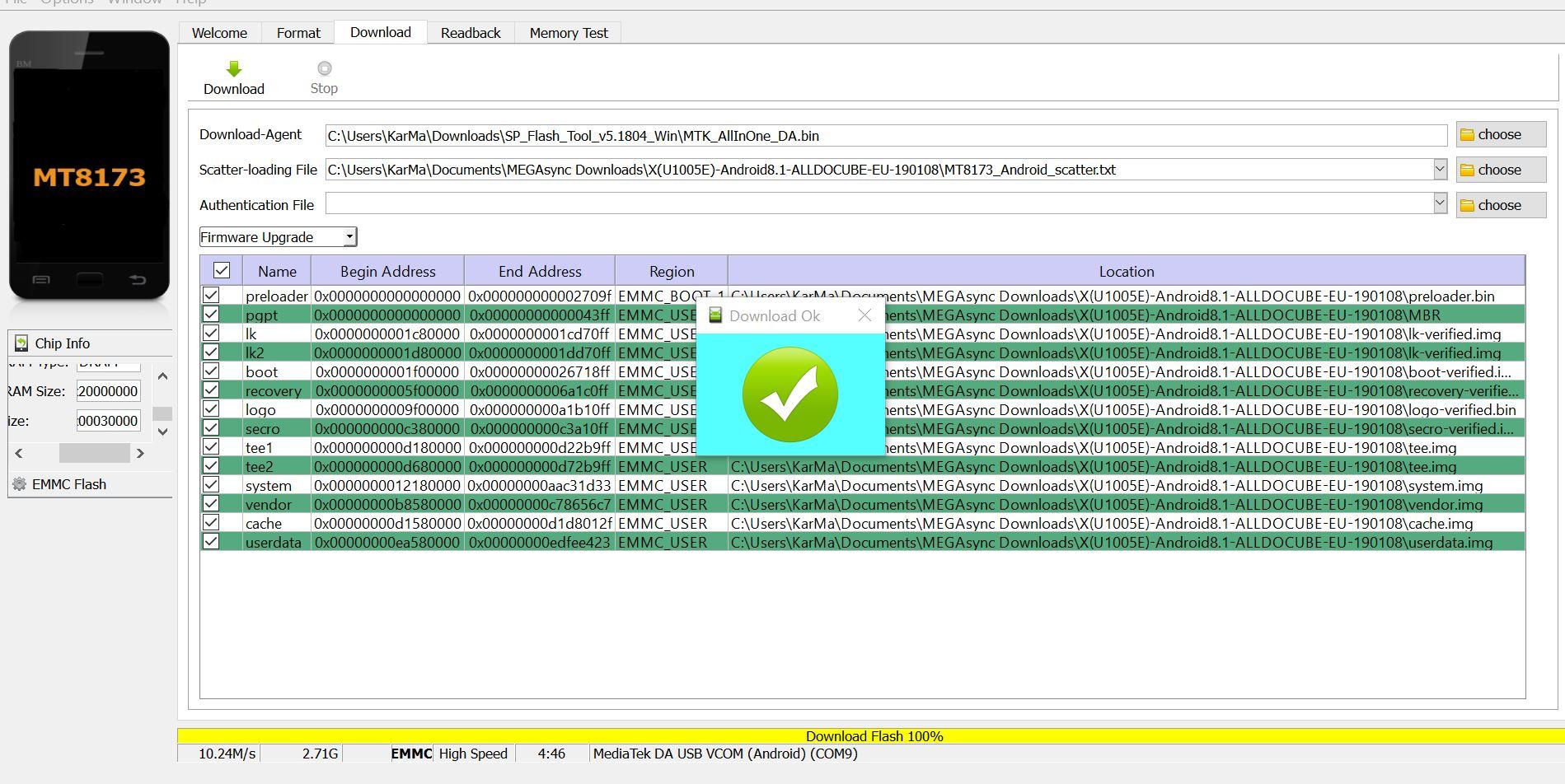

Hi Alex,
I used the MTP driver tool from the alldocube page. When I was synonymous to the chipset data displayed on the left. With a newer version of the SP Flashtool I did not get any values ​​left.
Nevertheless, the download works fine, the pad is also recognized by the signal, but it does nothing after the download.
Do you have another tip?

after re-flash firmware to tablet,please connect tablet to PC,and see the new device in windows os device manager. is it a com port device or other device.
and also you can press power button,connect tablet to PC ,and see what new device pops up in windows os device.
if the new device is  a mtp device,problem that the machine does not display may be caused by the screen or the screen cable.

Hello win2tabless,
I have tasted it with the flashing a few more times.
The device always displayed “MEDIA TEK DA USB VCOM (Android) (COM9)”.
The dowloading process was always very fast.
The last time I tried it was the following: “MEDIA TEK PreLoader USB VCOM (Android) (COM7)” and the download took much longer than usual. I read that the preloader is the right driver.
Since the last attempt but nothing more. Not even a short flashlight and the flashtool will not start download anymore.
The device is recognized by the PC but still – at least the typical signal.
