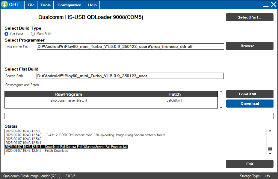

2025-06-07 16:06:00
Install driver for Qualcomm 9008 mode Manually enter the 9008 port mode (press the power,Volume up and down keys at the same time when the power is off, until a black LOGO flashes on screen ) Use Qualcomm QPST tool…
스크린샷 2025-06-07 164344
Did I done anything wrong?
I entered edl by adb typing adb reboot edl
original firmware version is 1.5.0.7
installed QPST, Qualcomm usb driver and pc recognize that tablet is in QDLoader 9008.
changed the setting into ufs
But keeps failing while installing new firmware.
here’s log of the installation

2025-06-07 17:02:36.091 17:02:36: ERROR: function: sahara_rx_data:276 Unable to read packet header. Only read 0 bytes.
2025-06-07 17:02:36.092 17:02:36: ERROR: function: sahara_main:982 Sahara protocol error
2025-06-07 17:02:36.092 17:02:36: ERROR: function: main:320 Uploading Image using Sahara protocol failed
2025-06-07 17:02:36.093
2025-06-07 17:02:36.094
2025-06-07 17:02:36.094 Download Fail:Sahara Fail:QSaharaServer Fail:Process fail
2025-06-07 17:02:36.095 Finish Download
